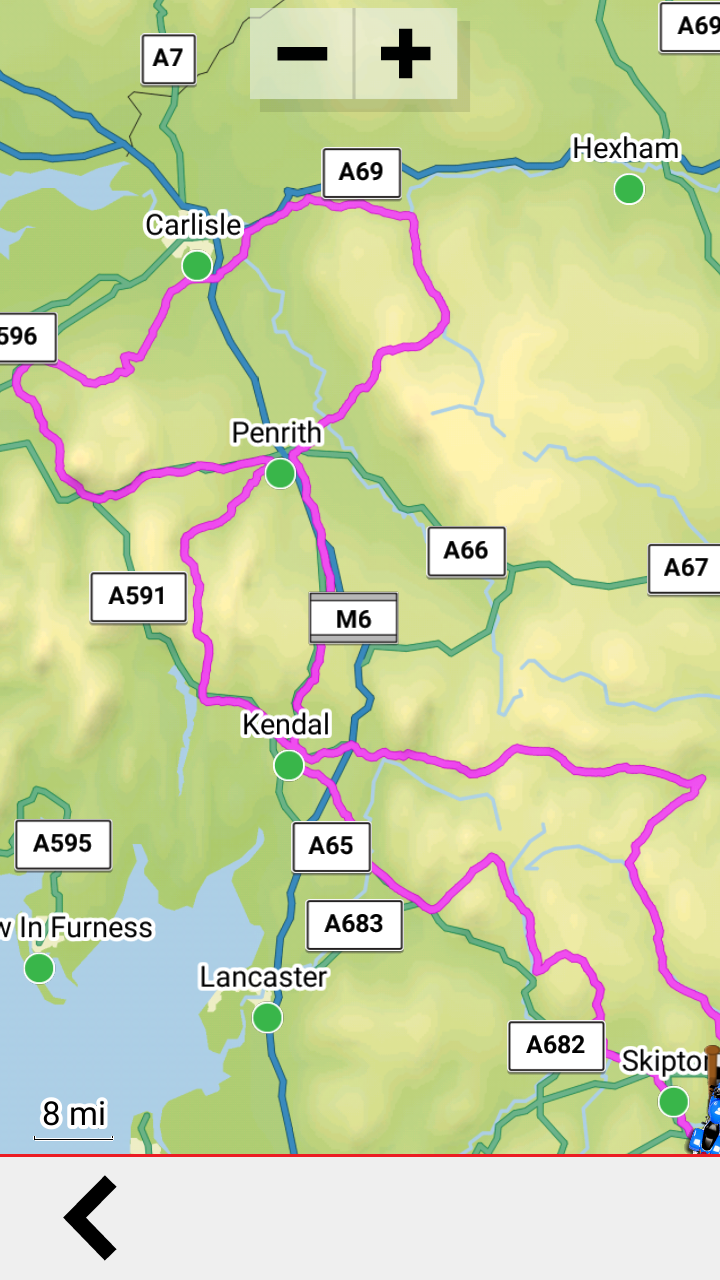

Or like this 250 round trip that I have just generated on my XT2.
The route starts at the bottom of the page and heads north up the right / east side of the loop. Then from the A69 it starts heading south down the left / west side of the route.
There are a number of places where the route heading north is VERY close to the route heading south - if you go off route - eg for a coffee stop - the XT2 will find a way to the nearest point on the route from your current position - and in places like Kendal and Penrith, that could easily find the section heading south, when you are still heading north. This is not what I think - I know this because I have tried it.
So what @smfollen was suggesting was to create two routes. In the example from my map, One route would take you north using the East / Right side of the map - up to the A69 at the top. The other would bring you back down the west / left side.
That technique prevents the problem of the satnav jumping onto the wrong part of the route
You cannot do this using round trip. However - you can insert an intermediate destination and it plots the first half and draws a dotted straight line back to the beginning, Perhaps when you get there, it calculates the return part of the route. I don't know. It seems likely. I'll have to try that one day to find out.
