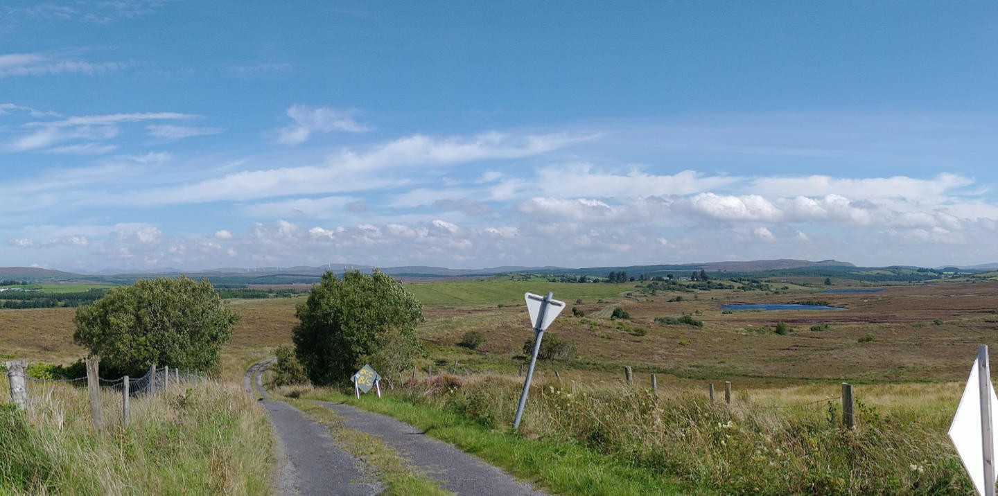

MRA's trip calculation times are a bit mor conservative than basecamp. Possibly for two reasons. I Europe tends to be a bit more congested than the US and what passes for a minor road in the US is very different than what passes for a minor road in Europe.
This is not untypical of minor or L roads in Ireland. You are lucky to average more than 30mph on some of these.

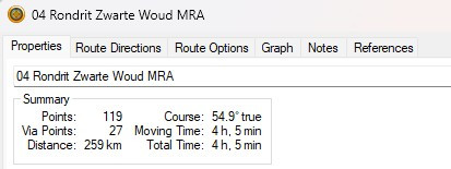

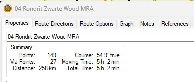

This tread is about the difference between MRA and Basecamp. But an other important factor is the MAP data. The same route in BC calculated with the CN 2026.20 and an OSM map shows only 1 km difference in distance, but 57 minutes difference in time. And yes they are visually the same.
CN:
OSM:
Every road is assigned a class in the map. BC, and the XT, use that road class to calculate the speed. Different road classes will give you different times.

Mzokk wrote: Thu Jul 24, 2025 11:39 am MRA's trip calculation times are a bit mor conservative than basecamp. Possibly for two reasons. I Europe tends to be a bit more congested than the US and what passes for a minor road in the US is very different than what passes for a minor road in Europe.
Similar problems up in Scotland where an "A" road might only be wide enough for one car, or a dual lane in both directions. And the one car width road might be an easy 60mph with good visibility, to a twisting adventure that at 30mph feels too fast.
