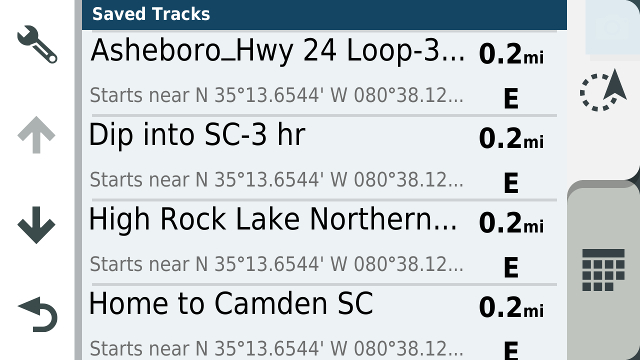

Posts: 2123
Re: Track distance in BaseCamp vs XT
I'm transitioning from curious to confused. This is my "Saved tracks" list when accessed via Apps > Tracks. All distance are to the Start point at the exit of my neighborhood. I don't find a setting that could change this. Did I miss it?
