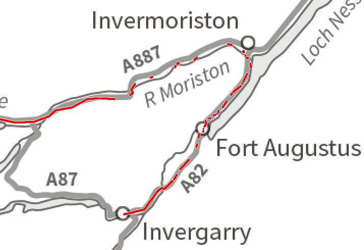

Regain wrote: Mon Jun 30, 2025 9:46 am The bar one was due to the XT2 being desperate to put us on a highway that ran alongside the minor road I'd selected. I ran with the Track but despite running a copy of the route as per our friendly expert @jfheath, it produced RUT behaviour in order to get us on that highway. I eventually had to stop the route and open it again with CEP once away from the highway.
I suspect that this was not RUT behaviour - it sounds like the situation that you get when the original route has been modified by the Tread App itself - ie routes are altered to follow the faster roads and shaping points are moved from their original location onto Tread's New Route.
There is a way that you can determine whether or not you have experienced RUT behaviour - if you allow the Zumo to automatically record your riding. The Track Log will be fragmented into tiny sections. Each break in the log will correspond to when the XT2 ussued a command to perform a U Turn. Here is an example:
Broken Track Log Example.png (49.39 KiB) Viewed 804 times
My plotted route was to travel from Invergarry west-ish along the A87 and then off the left hand side of the page. In fact, I needed petrol and knew that the only place was in Fort Augustus - so I continued NW along the A82. The satnave was asking me to turn back, and each time it did so, it produced a break in the automatically recorded log file. At Fort Augustus, the distance to turn back (A82 SW then A87) is exactly the same as it is to continue NE to Invermoriston and then take the A887. Approx 24 miles. After Invermoriston it took much longer to calculate the route back to Fort Augustus, Invergarry and the A87 - to reach the point where we were heading anyway - where the A87 meets the A887. Nevertheless it continues demanding U turns, and gives up about 4.5 miles from that point. Up to that point it was demanding that I turn back - 37.5 miles.
That is RUT behaviour. You can only begin to suspect it when you have reached the tipping point - the point where if you start a route and head to the destination the Zumo will plot one way, and if you go back a mile, it will plot the other way.
But the clincher for me is this track log - it has only ever got fragemented like this during RUT behaviour, and I have proved to myself beyond reasonable doubt that the break in the track correspond with the period when it is recalculating the route.
Track logs are to be found in Internal Storage/GPX/ CurrentTRackLog.gpx and in the Archive folder. It keeps them for about 6 months.
I'd be curious to know whether or not your track log for that date, time and location had become fragemented.
If you record a track manually by selecting Track Recorded on the XT2 main screen - that log never gets fragmented.
If you want to know more about how to use these - drop me a PM or start a new thread.

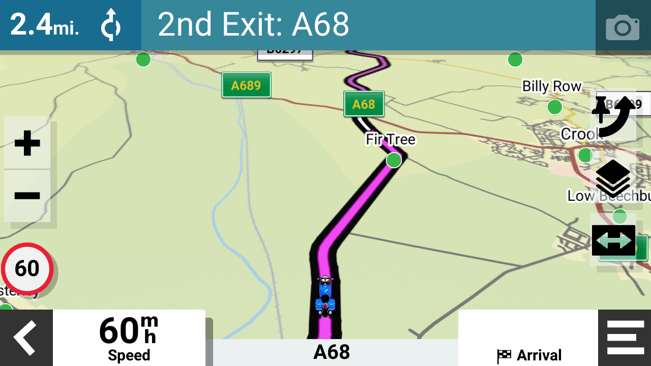

You mentioned that you set the track to Widest Red. I believe that also sets the magenta route to be the same width.
Most of the time, the route obscures the track which is the same width underneath. You can make some simple edits to the theme file to make the track wider than the route. I use black for tracks, and I can see the black track under the magenta route as a black outine either side of the route.
Like this:
If you want to know how to do this - it just needs a text editor and a bit of know how - so just ask.

Thanks for the response. 100% it was the XT2 routing me onto the highway. I’ve kept Tread out of the loop at home and sure enough, same result. Unfortunately I’ve deleted everything now so can’t do as requested. More shaping points has cured it, even with Tread sync.

Regain wrote: Tue Jul 01, 2025 8:19 pm I did find it frustrating that the route wouldn’t snap back onto my track despite running a copy. The Zumo simply wouldn’t let go of the highway and asked me to repeatedly u-turn. Not a massive problem as it was only a couple of miles and an easy fix. Is that not RUT? Sorry I can’t provide track segments.
I've had situations like that, that have turned out not to be RUT. It has just been that from where you are, going back is the 'best' way to get to the next route point - according to its algorithm - which we know prefers faster roads.
A single point on a side road to avoid going back to a fast road will not work with the XT 2. Two points spaced at 1/3 intervals often does the trick.
It can be difficult to prove RUT behaviour. But the broken track log is a very good pointer.
I know how to force it to happen. So I can use that to prove that our solution prevents it. I have been unable to make a recalculated saved route display RUT behaviour when recalculated imported route will always display it
app.php/ZXT-P105. That whole section is to do with RUT
Having the track logs is a much easier proof.
