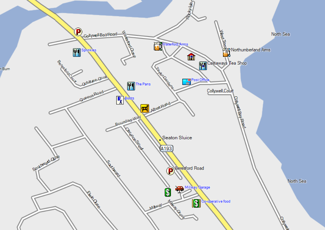

I'm wanting to see POI's in Tread that you can certainly see / find if you were browsing the map in the XT2 / Basecamp.
For example:
For example:
- Screenshot 2025-06-21 082759.png (307.05 KiB) Viewed 1070 times

The POIs that are on the right hand side search menu in Basecamp show up on the BC map if the approprate level of details is shown.
They are not included in any GPX file that is sent to the Zumo unless you select one and make it into a waypoint.

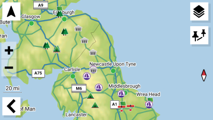

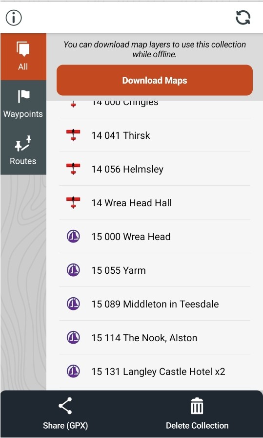

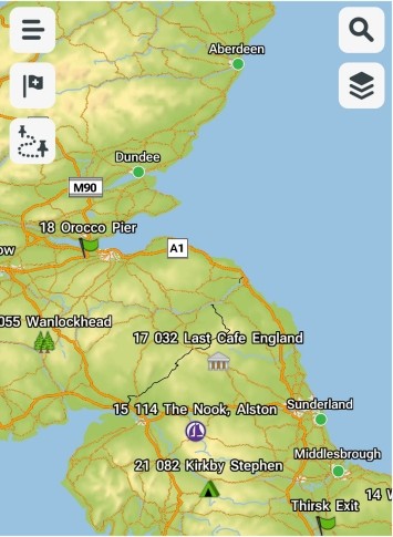

Re: POI's in Tread - How to make them visible
Screen shots of a quick test.
I had a number of waypoints saved from a recent tour. These were created in Basecamp. I altered them to have some different images associated with them. All done in BAsecamp and exported to the XT2 as a GPX file.
Waypoint showed up on the XT2 screen whether or not up ahead places was ticked (so that is different from the early XT1).
The icons were identical to the ones that I selected in Basecamp - in the waypoint property dialogue box.
I then enabled Tread to synch with my older phone.
The waypoints synced immediately and showed up on the map as the same icons that I chose in Basecamp.
But these are waypoints - not the POIs that requires POI loader to get them into the Zumo.
