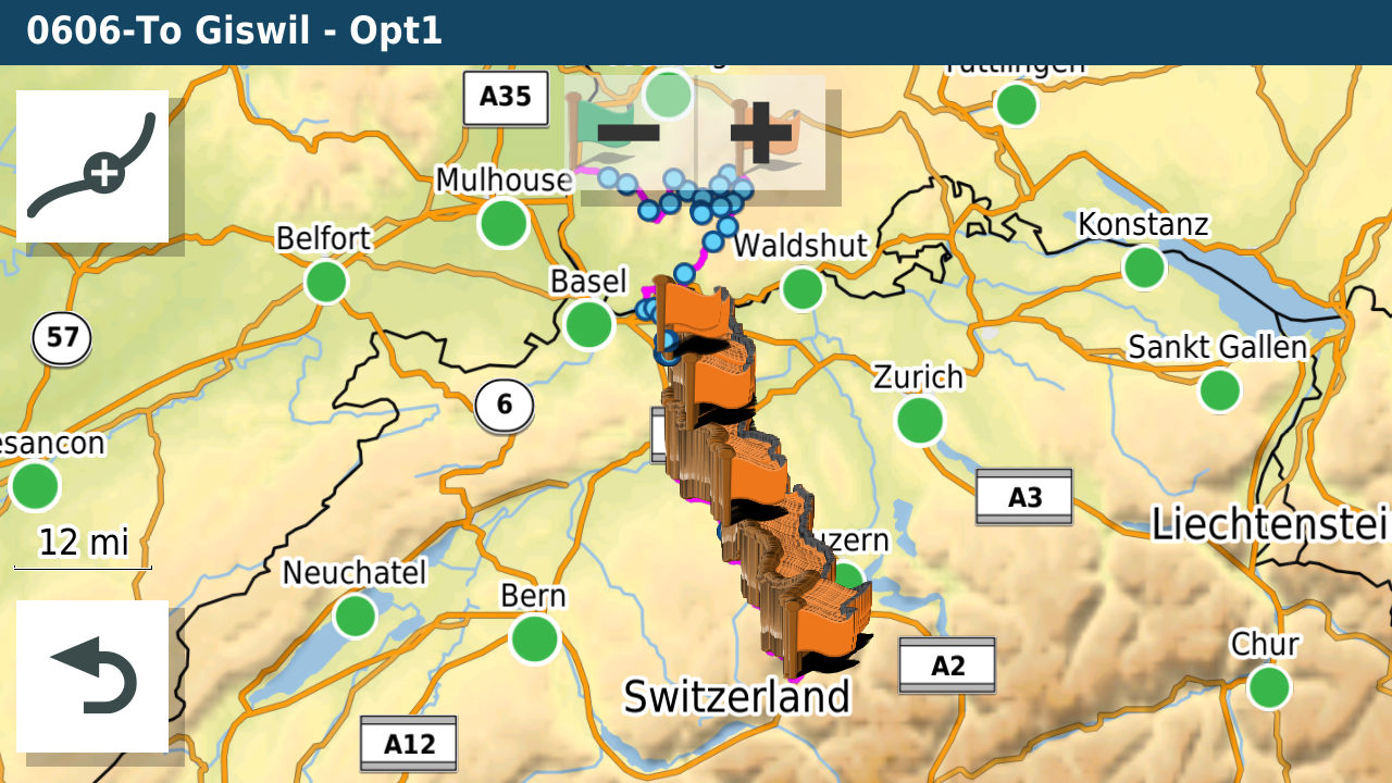

I'm taking a group to the Alps next week so loading my route files into the XT. But some of the routes have gone a bit crazy in Switzerland with the route just turning into a mass of flags and not seeming to show any other detail of other Swiss roads when loaded in to Trip Planner:

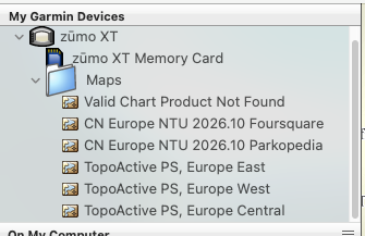

Whilst trying to figure out what on Earth could be happening I spot that Maps listed in Basecamp show the error of Valid Chart Product Not Found where the 2026.10 should be listed:
I waited quite patiently but it never seems to update to the proper name.
I checked the XT and the 2026.10 map is listed:
I've re-installed maps to both Basecamp and the XT via Express but it doesn't seem to make a difference. Though strangely the Menu on Basecamp calls it's installed map 2026.1, though the linked file is 2026.10:

It's normal, that Basecamp doesn't show the last '0' in the maps name, that was always so - i think, reinstalling the maps on the Zumo XT might help, maybe there was an hickup while installing them on the Zumo XT. Did you intall them via WiFi or via GE the first time?

It is definitely a map error - there seems to be chunks of Switzerland that are missing, though strangely not where my route above goes

I am still getting Valid Chart Product Not Found instead of the map name in the Zumo Window in Basecamp, but if it is working I can live with that as I only ever use the map saved onto the computer.

Yes, this was definitively a fault in the maps, here are two screenshots of that region on my Zumo XT
Regarding the map error in Basecamp - do you have also another map than the original Garmin one's on the Zumo XT?
Also it looks like you're on a Apple, right? Maybe there is some problem with reading the unlock .gma file for the City Navigator maps...

Yeah I'm on a Mac, I don't see why Basecamp would have trouble reading that file but it's possible. Where would it be stored on the XT? I'll see if it is in the right location.

I have 2026.10 installed on Basecamp, my XT2 and my XT1
