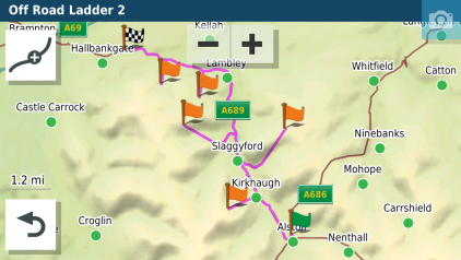

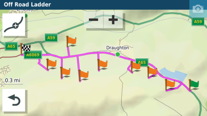

Like this:
and this:
Both routes on roads running alongside a hillside. No navigable roads there, so find-your-own-way straight lines it is. A couple of the spurs manage to find a cart track for part of the trek, or someone's drive !
