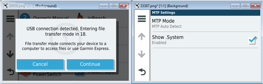

Typically, the XT will recognise that it is going into data communication mode and give a 20 second countdown before it does so. On that screen you can confirm you want to transfer data or reject it. Save 20 seconds of your life for doing something more important like watching paint dry. Maybe you didn't notice the countdown ?
The left hand screen pops up as soon as I plug in the USB cable to either a power USB socket or to the USB socket on my computer.
The right hand screen is the only place that I can think of that may have any effect on this (though I am not convinced).
That is in the hidden system config menu - long press the circular speedo after tapping the speed button on the map screen,
then Configuration and Settings -> MTP Settings.
You'd probably want to show .System. (Not advisable for everyone - beyond here there be dragons which eat important data)
"MTP Mode" has three options. One is USB Ethernet. I don't know what these do - although I have seen USB Ethernet adaptors. Whatever - mine is set to MTP autodetect. (Media Transfer Protocol).

For me, this typical behaviour had always occurred when connecting to a PC but not when connecting to an AC adapter, until I found an AC adapter that caused atypical behaviour. I hadn't tested what would happen if I cancelled out of the "USB connection detected..." prompt and then put the XT to sleep so I just tried it to see if the "Charging the battery..." notice would appear. It did. It appears that this AC adapter is charging, it just triggers the USB connection prompt not triggered by other adapters.jfheath wrote: Wed Jul 17, 2024 7:40 am Typically, the XT will recognise that it is going into data communication mode and give a 20 second countdown before it does so.
