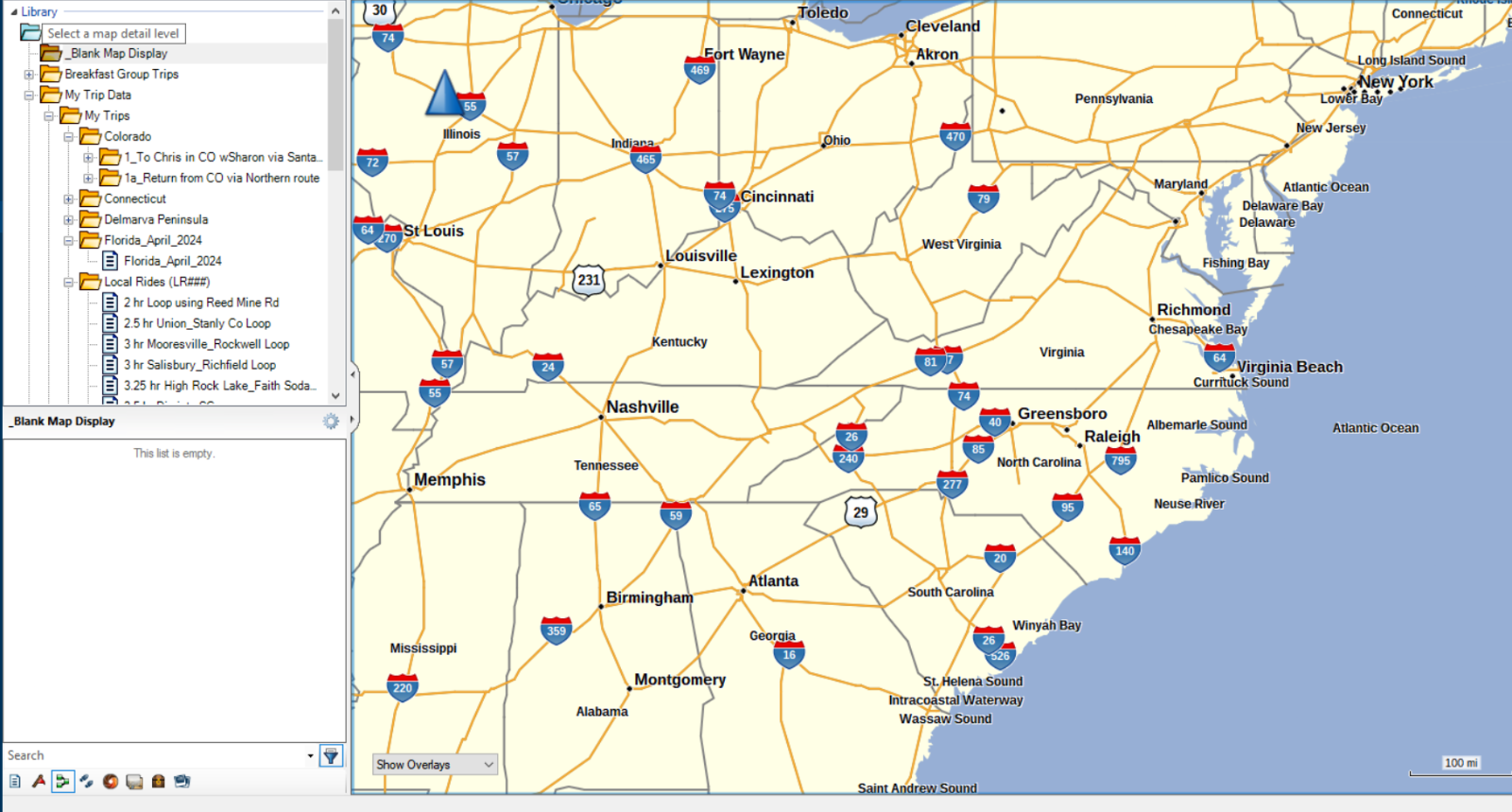

@bicyclenut , regarding that image and the cluttered map, I found a trick that resolves that for me. I created an empty list folder named "_Blank Map Display". It sorts to the top of My Collection and displays an empty map. Selecting that list folder before closing Basecamp results in Basecamp opening with a blank map on next startup.
