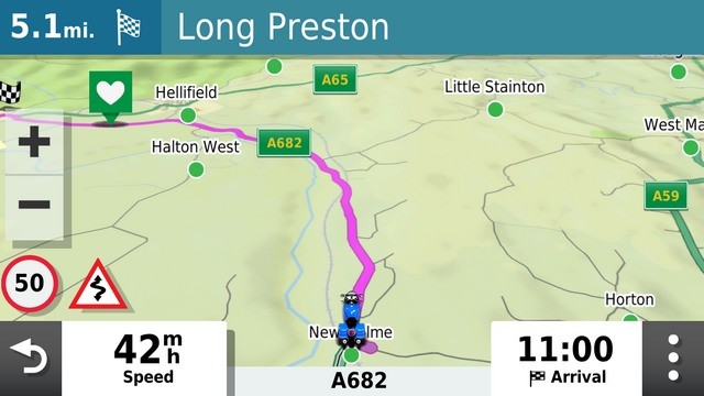

A682 Planned Route.jpg (51.27 KiB) Viewed 1618 times

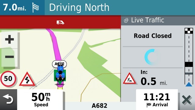

A682 - XT spots road closure..jpg (43.17 KiB) Viewed 1618 times

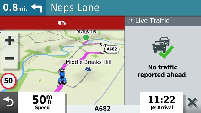

A682 - Avoided Closure.jpg (46.53 KiB) Viewed 1618 times
The display when it spots the road closure very rapidly disappears, and the route ahead is now altered to get around the closure and return as quickly as possible to the original route. So on the new root (including the big loop to the right at the top of the map - there are no traffic reports.
I have seen road closure signs on plotted routes, but I could not get them to appear today. But I did notice that the XT only looks ahead to the next Via Point. Maybe they appear for sections with closures after the next Via Point.

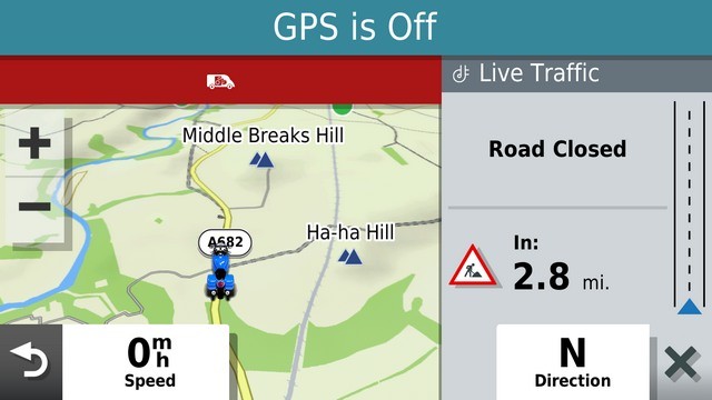

If you stop navigating and look at the map with your current location at the centre - then the same message shows up.
A682 - No Active Route.jpg (43.88 KiB) Viewed 1618 times

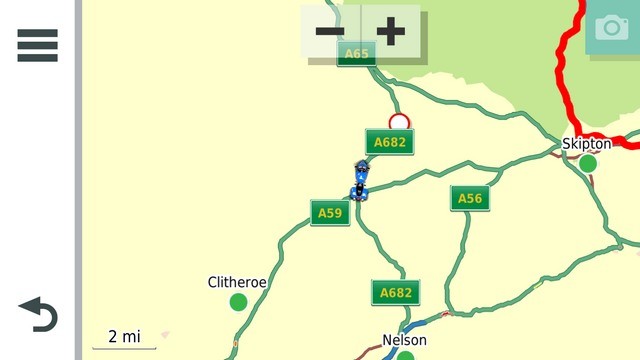

And if you then tap on the map to pan around or zoom out and in, the location of the road works can be found.
A682 - After tapping map.jpg (29.36 KiB) Viewed 1618 times

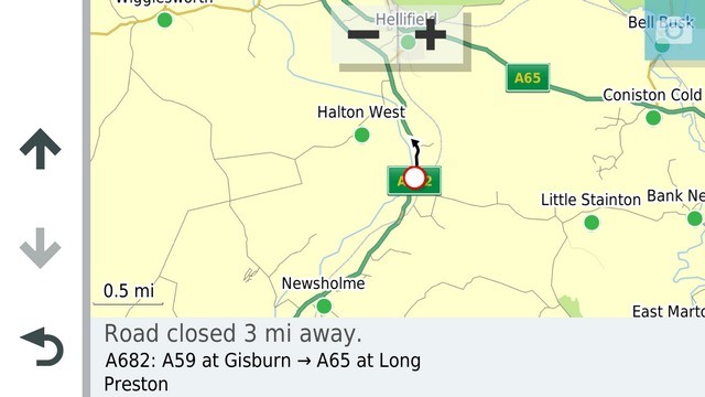

And tapping the red circle gives more information
A682 - Tapping Red Circle.jpg (42.42 KiB) Viewed 1618 times

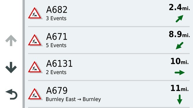

If you have the Live Traffic widget displayed on the right of the landscape screen, you can tap that.
Note that we now have the 3 bar menu in the top left. THis gives access to two other displays. Incidents and Legend.
Incidents looks like this.
A682 - Traffic Events.jpg (29.46 KiB) Viewed 1618 times
And then click on the A682 Incidents
