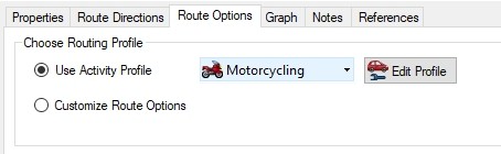

So, back to the OP's question, "... do you know how to allow unpaved roads on one route without effecting other routes?"
The answer is yes, I do know how to do this. Change your route to be customized and untick the selection for unpaved roads as an avoidance. Do this while the route is showing in Base Camp. Upon transfer but prior to importing, use Base Camp to view the route on the device, re-customize if needed. I find with most of my routes (I put mine on the SD card exclusively) the customization from Base Camp goes with the route as evidenced by the changed symbol and the activity profile still shown as None.

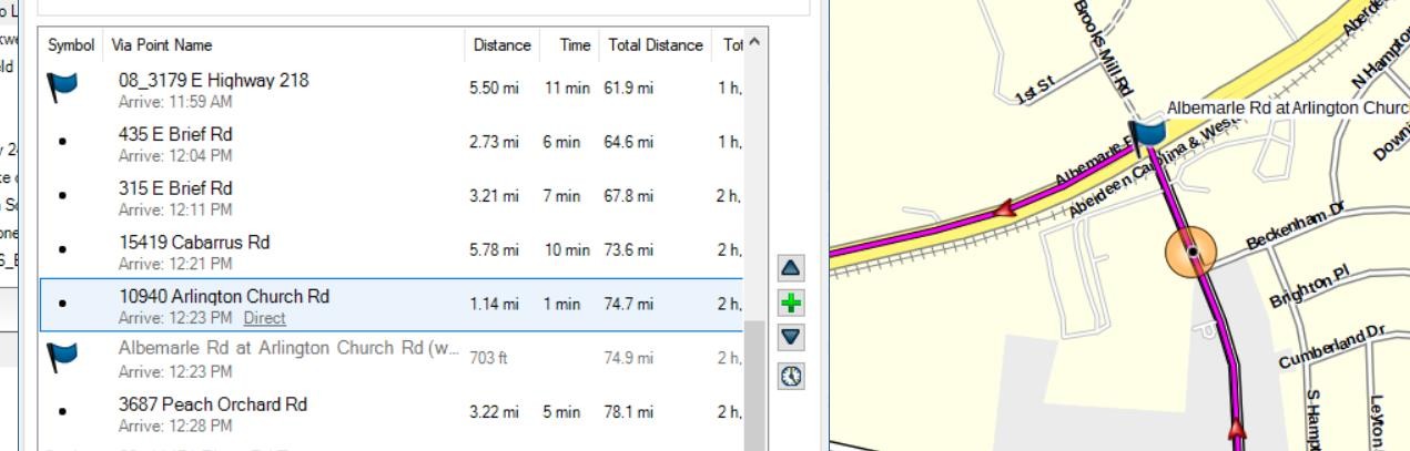

Getting back to the original question and my associated recommended solution of assigning Direct to selected segments, I just came across a similar use for this technique. In the below example I am riding north on Arlington Church Rd and then turning west on Albemarle Rd. The map says that I can not turn left there (even though I can) so it creates a route that goes right then does a u-turn. To overcome that I added a Direct route point on Arlington Church Rd followed by a waypoint at the intersection of Arlington Church Rd and Albemarle Rd. The result is that BaseCamp now includes the left in the route.

This is brilliant and I really appreciate the screenshot. Thank you very much.Peobody wrote: Fri Nov 10, 2023 10:21 pm You can set a profile at the waypoint level What this allows you to do is to create route points along the unpaved road. Once added to the route you can open each one, from within the window that opens when you double-click a route, and assign 'Direct' routing to it. This will force BaseCamp to route with straight lines between these point. If the unpaved section is long and curvy, or has turns, you may desire a lot of points along it.
Note: When you do this, set the 'Direct" option in the starting route point of each leg that you want to have direct routing.
