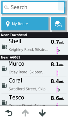

The following display appears. I've turned the XT into portrait view this time - it only gives one more row, but it is scrollable.
This list is dynamic - it is constantly updating as you ride, and you can turn back to the map at any time.
UpAhead 2.png (37.04 KiB) Viewed 2323 times
Because there is a route running, the display is related to your route.
Near Townhead - shows a petrol station 0.7 miles away off route to the right.
Murco is a petrol station on my route 8.1 miles ahead
Coral is a station 8.4 miles ahead, off route to my right.
This display only shows petrol stations that are ahead on your route. It will not show any that you have just passed.

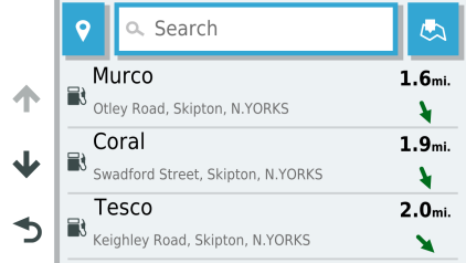

You get a different display if there isn't a route active.
Up Ahead 4.png (32.38 KiB) Viewed 2323 times
In this case the display is relative to your current position, and indicates with an arrow in which way you need to head in order to get to the fuel.

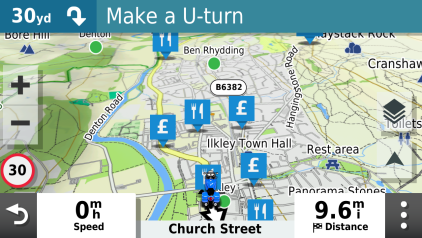

With up ahead places turned on, then icons pop up on the map to indicate the location of the 3 categories that you have selected. I have turned the side bar menu off for this screen shot.
Up Ahead 3.png (152.3 KiB) Viewed 2323 times
In this case there are no petrol stations except for one just off the top of the map, but you can see the banks and restaurants cluttering up the screen. I was well off route on this occasion - you can see the route U turning me off the bottom of the screen.

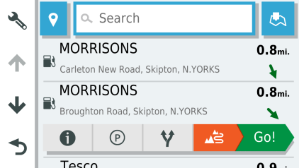

If you tap on any item in the list, a display like this one below shows up.
Up Ahead 5.png (37.86 KiB) Viewed 2323 times
If you tap the information icon (i), then it shows a map inset, showing that section of your route and where the petrol station is in relation to the route. The information screen also shows your arrival time , distance and how long it will take to reach it - along with the address and phone number. If you want to add it to the route, select 'Go'. If not, just return to the list.
