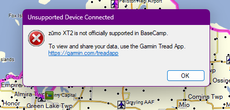

BaseCamp 4.7.5 does not support XT2
Just getting familiar with the Zumo XT2 over the last week. In many ways an upgrade, in others a setback. It replaced my Zumo 595LM on my bike, and will soon replace the Zumo 595LM on my wife's bike.
I was able to connect to the unit via BaseCamp after closing the pop-up box.
The whole, you need your phone to use the unit is a little disconcerting. I'd like to be able to not have to look like the Star Ship Enterprise while I'm riding but so it goes.
I could send it a route. It lands as temp.gpx and once I import it, I can select from routes contained within. It seemed to massage the route for the map, and then it synced to the Tread App as well.

Re: BaseCamp 4.7.5 does not support XT2
What I have learned thus far...
You don't need Tread App to do most things BUT the Tread App is KING regardless of what you last did on the unit. Beware what you delete, move, alter, etc., on Tread App as it will permeate to the unit.
BaseCamp 4.7.5 to ZUMO XT2
After hitting OK on the "You can't do it pop-up" the device shows in the folder structure of BaseCamp.
You can copy / move routes to the XT2 Internal Storage.
NOTE: I highly recommend you check and correct your WAYPOINTS and SHAPING POINTS and recalculate based on the latest map BEFORE copying/moving to the unit.
Import the routes, assign to the Collection or create a new collection.
Load the route to see that it matches what you intend it to.
If you're so inclined, sync to the Tread App.
Done.
