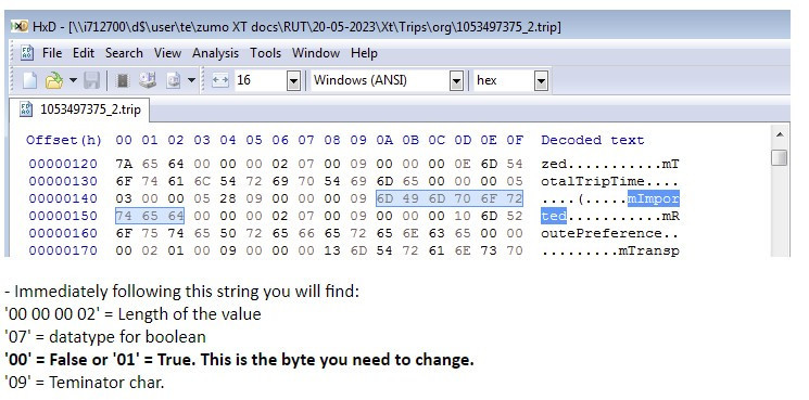

Multiple tests carried out reveal that a ‘Saved trip’ will recalculate the route/trip to the next Via/Shaping point when you deviate from the route. For an ‘Imported trip’ it will try to get you back by requesting U-Turns. This procedure modifies a bit in the .trip files that defines whether it’s an Imported or a Saved trip. Thus changing an ‘Imported trip’ to a ‘Saved trip’ and consequently changing the routing behaviour.

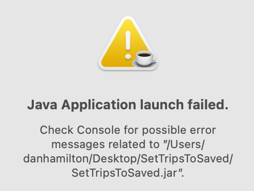

No joy with running the Java app on my 2017 iMac with Ventura 13.4 OS and Java 8. But the alternate method of using an online hex editor works just fine and is not dramatically slower given the need to connect the XT and transfer trip files to the computer anyway.

I have no answer. Yet. Maybe someone with Mac experience can help?
I doubt it has to do with pathnames. I just tried it on a Linux system, that worked.
One thing I noticed, the program needs a graphical window. That has to do with the folder selection dialog.
Next Thursday I will have access to a Mac and try it.

In case this helps another Mac user to diagnose, the program does start OK and does display a file selection graphic window (attached), but crashes as soon as selection is attempted:
