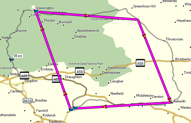

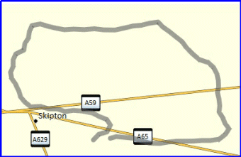

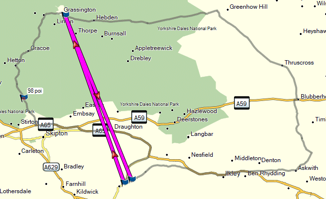

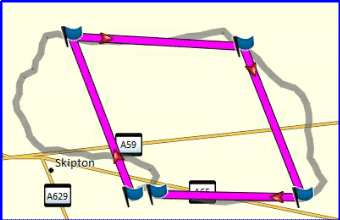

The screenshots of each of the 4 routes generated by MyRouteApp are taken from Basecamp. Please note that when the XT gets these gpx files, it automatically calculates the route between the route points. You don't see a map with straight lines. This is just how Basecamp sees them, before the recalculate button is pressed.

GPX v1.1 (Route, Track, POI) Updated 8/1/22, checked 1/6/2022
Via Points and Shaping Points are transferred correctly for the Zumos XT, 59x and 39x
GPX v 1.1 produces a route which contains the main route points, with Start, End, Shaping and Via Points. The start and finish points are plotted as Via Points. Intermediate points are set to Via or Shaping according to the MRA status of Hand / Tear Drop (or Hard / Soft).
The gpx file contains no detail of the roads to be ridden so the route is shown here simply as straight lines. The Zumo will calculate its own route on loading so the map on the XT screen shows the actual roads to be taken. This route may be different from the roads that MRA selected, but will still pass through all of the points in turn. The track is an accurate reflection of the route that was drawn.
The XT can convert a track to a trip (without intermediate points, but will not deviate from it) and of course the track and the route can both be drawn on the same map to aid navigation.
This is now the option that MRA recommended for the XT when I contacted them about using v1.1 not sending the shaping points. The Interface on RMA still has an info button saying that v1.2 has been tested for use with the XT - which I find a little confusing. Shaping Points and Via points are both sent to the XT, and the XT will automatically calculate a route to between these points. Prudent placing of shaping points and attention to the routing preferences will create a pretty good match to the route in MRA.

GPX v1.2 (route, track, POI) Updated 8/1/22 and modified again 18/3/2022. Checked 1/6/2022
Only Via Points are Transferred, not Shaping Points
v1.2 (route, track POI) has recently changed and now plots a route between the Via Points in the order that they appear on the MRA route. However, none of the plotted Shaping Points are included.
In Basecamp this draws as a straight line - as shown, but in the XT, a proper route is drawn along roads. This is because MRA has recreated the same trick that Garmin has always done with BC and Mapsource - it keeps the route intact by defining it with hundreds/thousands of intermediate invisible 'ghost points' - and sends all of this to the Zumo. The Zumo keeps this route intact, unless it recalculates the route when all is lost. With no Shaping Points in place, this can result in a very different route.
In my experiments, this route behaved like Basecamp routes with Shaping Points removed from the route. That is, the plotted route on MRA and BAsecamp is retained exaclty as it is - as if the shaping points were in place. However - as soon as the route is recalculated, the XT has no knowledge of the shaping points, and calculates a route which visits only the Via Points.
However, normally with different mapping, the Zumo would re-calculate the route on transfer. In a few of my tests the XT recalculated v1.2 routes on import, but on other occasions it does not. I think that this may be to do with the difference in when HERE maps are updated and when Garmin publish their version for the XT - but this is a guess - a working theory which I cannot check until the maps change again.
At present 4 Jun 2022 using CN Europe NTU 2023.10, V1.2 routes are not being recalculated on import to the XT.
GPX v1.1 (track, POI)
v1.1 contains a track. Although the caption indicates Points of Interest, I didn't use any in my test routes. POIs are placed separately, and I could not find a way to make them an integral part of a route. However, if used, MRA exports these and they appear in the Favourites / Saved locations of the Zumo.
